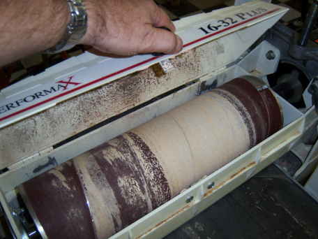

I have the Performax 16/32 sander and ever since I changed the paper on the first roll of paper that I wore out I have had some problems. I figured out that I was winding the paper backwards when I started tearing up paper left and right, but now I seem to have problems with burning the wood and also the paper loading up (see pictures)
This is 120 grit performax paper and it doesnt seem to last long at all. I loads up like crazy and burns the wood. What paper do you use and where to get it? Am I doing something wrong?

I use 80 grit and set the conveyer belt to run pretty slow.I get a little loading and burn sometimes,but most of the time I`m okay.As soon as I notice any loading at all I clean the belt with one of those gum rubber sticks that woodcraft sells.I also have never been able to figure out which way the arrow on the back of the sanding belt goes.I assume it goes the same direction as the drum spins.Hope this helps.

I have one of the rubber erasers from Woodcraft (you can see it in the bottom pic) but it doesnt seem to help.

Same machine here. Some of the more oily woods will be more prone to clogging. I would only ever use 120 grit on spruce, all others 80 git is the go and if I have a fair bit to hog off, or if it is really oily wood, courser is better, even down to 36 grit to get the bulk off.
Make sure that you have very good extraction or this will cause problems as well. I also run my feed at around 70% or slower for most stuff and, where possible, feed at an angle to the grain finishing with the grain only using a few very light passes.
On that note, remember, this machine is essentially a sander and not really a thicknesser in the true sense of the word. It is meant for lite passes only. If you get too greedy trying to hog off too much at once in order to save time, you will pay. Take it steady, get into the mind set that this job needs to be done right.
If you want time savings, try using a Wagner Safe-T-Planer to get things down closer to finish thickness first and try to remember how long this task would take to do as accurately if you where doing it all with a hand plane.

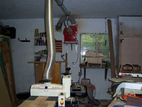

You need much more vacuum! The dust is going around and being compressed back between the paper and the wood causing load-up and a tremendous amount of friction heat. The cleaner sticks help a little, but once you have burnt resin stripes, games over. Then you need to buy Wurth pitch and resin remover. Put some in a coffee can and let your belt soak for awhile, take out and rinse and you will believe you have a brand new belt! I use it for my hand-held belt sander, my 16/32 and my 43" wide belt. Here's a link. Go to page 10.

The directional arrows are vestiges from using lap splices on sanding belts.   You don't need to pay attention to them on hook and loop strips for drum sanders; except in some very exotic abrasives, there is no directionality to the grit, and in fact, reversing the paper when it seems worn will actually expose fresh sharp grit.
Most of the cloth backed sanding strips and belts can be cleaned with a high pressure washer.   We do that on our wide sanding belts.   You can even take them to a car wash, though that pressure isn't generally as high as you might like.
As has been stated above, don't try to take too much off at a time.
Run resinous woods through slightly diagonally until final very light passes.
The better your dust collection is, the less dust and resin build up you'll get...I almost can't stress this highly enough.   A lot of that is the dust sticking to the drum and then getting mashed into the crevices between the grit as the drum comes around again.
Read Sando Nagyszylanczy's book on small shop dust collection and design a "stripper"...kind of an air knife to blow the dust off the drum and into your dust collection hood.

Your problems are more than just one.
1. You're trying to sand deeper than you should.
Go slow, take little bites as Hesh says.
2. You're using too fine a grit for thickness sanding.
Use 120 for final sanding only, and very light passes.
3. Better dust collection will help, but it's not the biggest issue.
If you're using oily woods, and if you're sanding too quickly or deeply, the oils will stick to the paper upon contact, and they will build on themselves as the drum spins through the wood. No amount of dust collection will prevent that. It's not just that dust is recirculating and getting stuck. That drum spins very fast, and in most cases, faster than the dust can fly around it. What dust does fly around it tends to stay airborn rather than settling right back down on the wood. The buildup from recirculated dust is actually minimal compared to the drum heating up and getting a coating that builds on itself as it's sanding the wood. It's mostly a combination of heat and pressure that does it. That's one of the reasons a wide-belt sander is so superior to a drum sander. The paper and unit run a lot cooler.
As I see it, the biggest issue here is that you're trying to do the sanding equivalent of driving an Escort like a Ferarri. Stay within the limits of what the tool was designed to do, get better dust collection when you can, and you'll be ok.

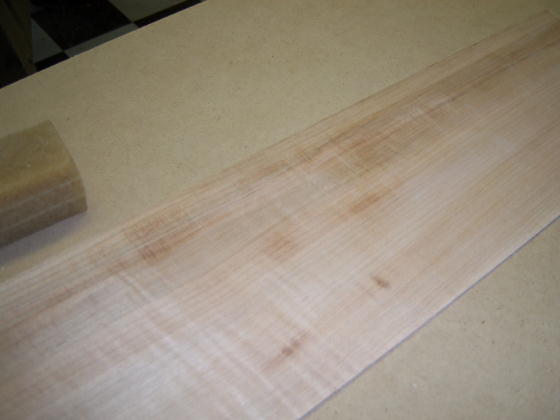

I really dont think it is a vaccum problem. My house vac system will literally suck an allen wrench off of the worktable. I do, however, believe it is a problem with the paper. I have been trying to take small passes as Hesh describes (1/8 turn) and it still happens. I dont know if the wood could be some of it, but this is some curly soft maple that I am currently working with.

Maple likes to burn. Going with a faster feed rate and lighter cuts will prevent heat buildup at the point of contact. The belts (as well as things like router bits) depend on fresh cool material to work in order to cool. Slow feed rates allow the heat to build up and once that happens you hit a kind of tipping point where the burnt sanding dust packs in on the paper and it all gets geometrically worse.

Don't eliminate the dust collector just yet - you mentioned a "house
vacuum". What kind of dust collecting system do you own or more
importantly, how much CFM - you are going to need at least 500 CFM for
your Performax to perform as expected. A regular vacuum (nominal CFM
but high static pressure) is far from ideal.
If you have proper dust collection and take light passes with 80 grit
sandpaper, you shouldn't have much trouble.
Best of Luck,
Simon
PostPosted: Sat Aug 04, 2007 1:05 pm
its a 650 cfm blower system and it vents to the outside (no collection or back pressure). I think I'll switch to the 80 grit paper.

I just realized that the shop vac on the floor might be misleading... i rarely use it... look above mounted to the wall and you will see the blower system I use. It is a 4" system and has a 6" exhaust that goes through the wall and into the chicken yard.
I also looked inside the exhaust port on the preformax.. there is not any kind of x brace or anything that would impede the flow of air except for the blast gate. I checked that for obstructions too...nothing there.

Lots of good advise above. With the Maple. I would say you are taking too much and you are moving it too slow. Lots of vaccume is great, because it clears the dust and really helps to keep the drum cool. Keeping the material(any material) moving quick enough will also help keep things cool. If the machine bogs as you run it fast, you are taking too much. If you can angle the material that will also help prevent spot heating. Using that little eraser is nice to clean the paper, but you need to use it often before you get build up(and it does little to remove baked on resin).
Peace,Rich
PostPosted: Sun Aug 05, 2007 8:44 am
Ken, I find that Maple is one of the easiest woods to burn. Soft Maple easier than Hard in my experience. It won't usually pitch the belt like, say, cocobolo will but it will cake it much like your pics show. Maple does have a sticky quality to it (think maple syrup) and so it is pretty easy for the dust to cake.
As said before, increase you grit size and back off on the cut. If 1/8 turn is normal, try it at 1/16 turn. And run the feed wide open. It will be slower sanding but the belts will last longer so you won't have to take a break and change them.
